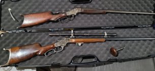

I had John Taylor in Lewiston Idaho convert a rare Stevens 47 from 25 Rimfire to 25-20. mine had a good bore and is. good shooter with shorter bullets.I can shoot. 258 diameter bullets in mine.

A Steven 47~? What a beautiful rifle. I've spoken to John and have a tenative spot on his work schedule for the end of October. I didn't even ask him about refinishing the barrel and receiver. Does he do all that work too~?
My 47 is on a model 44 and worn quite a bit but it has the original sight set. It was 3 months from the time I sent it to him. He converted it to center fire and re chambered it and I think it was under 300.
it's the top rifle.bottom is a stevens pope 32-40 also a model 4720220301_214748.jpg
it's the top rifle.bottom is a stevens pope 32-40 also a model 47View attachment 1355651
