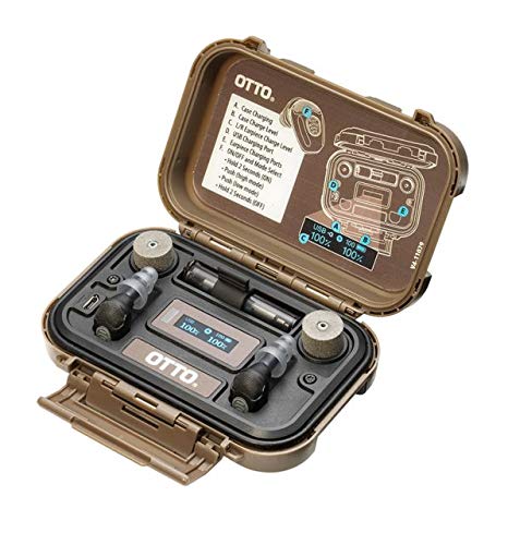

The best hearing protection device I've ever used are the Otto NoizeBarrier Micro earbuds.
I've tried everything and these things work better than any ear muffs that I've ever used. They are expensive but you definitely get what you pay for.
