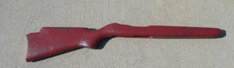

I have used acraglass gel many times. thin it down, put a even coat down, texture with gloved hand, pot scrubber, anything. Paint with duracoat, clearcoat with flat automotive clear.

As for using Acraglas.......it never dawned on me that I could use that or Devcon 10110 bedding compound or JB Weld compound and thin it down a little. (with laqur thinner or acetone?) Then I can apply it with a fine roller. Both those substances have a nice long 45+ minute drying time too!
