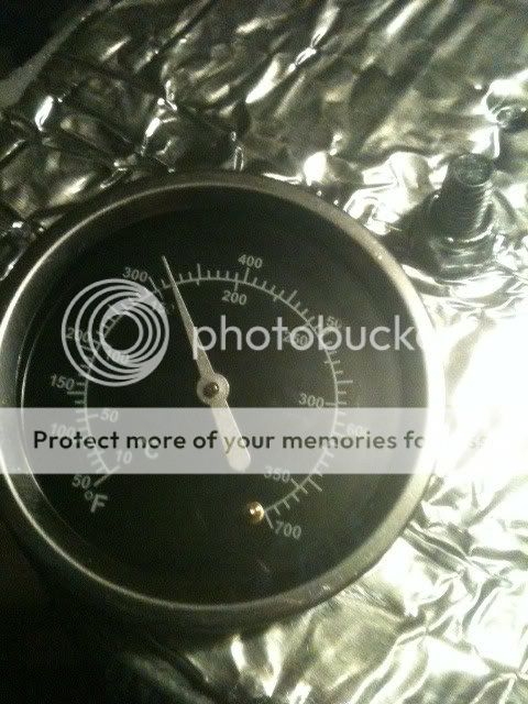

This is a picture of the oven with hot plate
Oven will hold this all day long. Notice the bolt to the eye hook for gun hanging

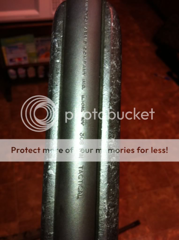

Paint set up, cheap harbor freight air brush with water filter on air line. Non clorinated brake cleater for degreasing and leather gloves when blasting. Use latex cloves when painting. Always wear a respirator and goggles.

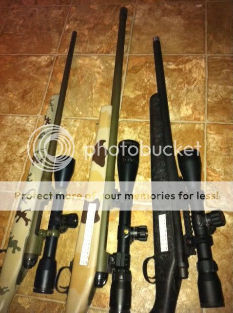

Couple of gun pics
I've got about $150 in this set up all together. I've done 4 of my guns and still have plenty of Aluminum oxide left for other guns. I'm might do a couple of guns for a friend in exchange for a trophy deer hunt at his family's land on the river. All in all turned out pretty well. The Norrell's is extremely easy to use and isn't coming off muzzles or muzzle brakes.
