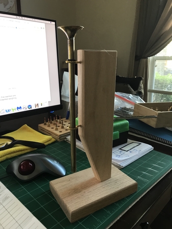

For your consideration, a drop tube with baffles to slow down the powder.
I added some brass baffles to an aluminum tube and I have it so I can drop a charge into my 505 scale the finish off with my Omega trickler. A few Varget kernels may jump out but a lot more splash out on a straight drop.
