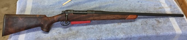

That was the inlet, the rest of the rifle was chunky as can be. At first. I was kinda peeved at how much wood I was going to have to sand to get it to be a sleek sporter. But then, I realized the tooling and rasp marks were so deep that I was thankful for the extra bulk.
All in all it was was a fun project shaping the stock and then sanding. I'd buy one again if I had the need. I'm still finishing my stock. I tried arrow wood finish and I have no experience with a hand rubbed stock finish. I'm not sure if I'm even doing it right. At one point I started back over with the finish. I'm struggling getting the topcoat look I want but also preserving the beauty of the wood without the finish making it opaque.
Soon I'm gonna give up and go to spar urethane or arm-a-seal.
Straight tung oil on my garand was way easier than this arrow wood stuff. But did not care so much about the figure on the garand.

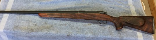

Here is my tikka stock before I went back to 320 and tried it again with the arrow wood.
This go around, I stated at 320. I wet sanded 320 three times. 400 twice, 600 twice, and 800 twice. And then started applying by hand I just have not been able to build any finish with it. Pores are 95% filled. Still not finish is building up. I've been only applying by hand. So I've told my self, I'm doing one very thin coat a night until the end of the month and then going to urethane if I don't like it.
