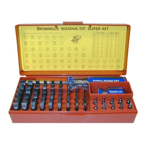

It's a little bit of coin but all you'll ever need. I've had mine for over 15 years...love it.
100% this kit. Lives in the top drawer of my tool cabinet. I use it every day.

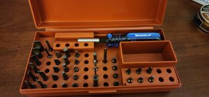

After some further investigating you guys suggestion. I opted for the magna-tips from brownells. I got a starter set along with some specific bits and torx that i needed. Really nice quality. Ive used them a couple times now and they seem like they should be around for years to come. There is one add on set that im still waiting on that was on backorder. Hopefully it wont be long. Appreciate the reccomendations. 20251105_204538.jpg
