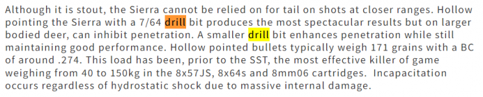

That web site's article about the 8x57JS Mauser cartridge (https://www.ballisticstudies.com/Knowledgebase/8x57JS+Mauser.html) recommends drilling a Sierra bullet, concluding that proper drilling produces "spectacular results" and makes the bullet an "effective killer" of NZ-sized game:

Todd, congrats for following the link provided and having a good ol' study.

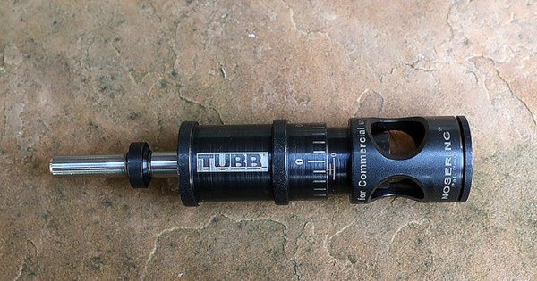

If you can afford the extortion money, there is Tubbs nosering tool that cuts a groove around the meplat causing expansion. It was designed for the DTAC. I got a few samples with a TMS kit but have not shot them yet. Or just buy the bullets already cut.
