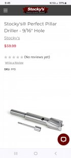

I use this style boring tool. I have a 5/16 pilot. I drill the original hole to 5/16 and then use the tool and it works great.

This is the way I have been doing it currently. Except using a proper fitting drill bit to center my setup in the existing holes. It works.... OK... but still they are off center some. I'm now thinking maybe I should not have been using a twist drill bit and maybe less wandering could occur with a forstner bit?
I think I'm going to invest in one of those pilot counter bores. They seem like the right way to go. I don't have a way to turn my own pilots, but it looks like they are cheap enough for me to get the right one.

Thanks for the input everyone, I'll see how those pilot bits do.
In the pre-mill days, the piloted counterbores in the drill press is what I used. Carefully enlarged the screw holes to 5/16" and then used a 5/16" pilot. :)
Send me your counterbore, and I'll turn you a (long) pilot. Don't waste your time putting it in a drill press or mill; do it with a portable drill!
