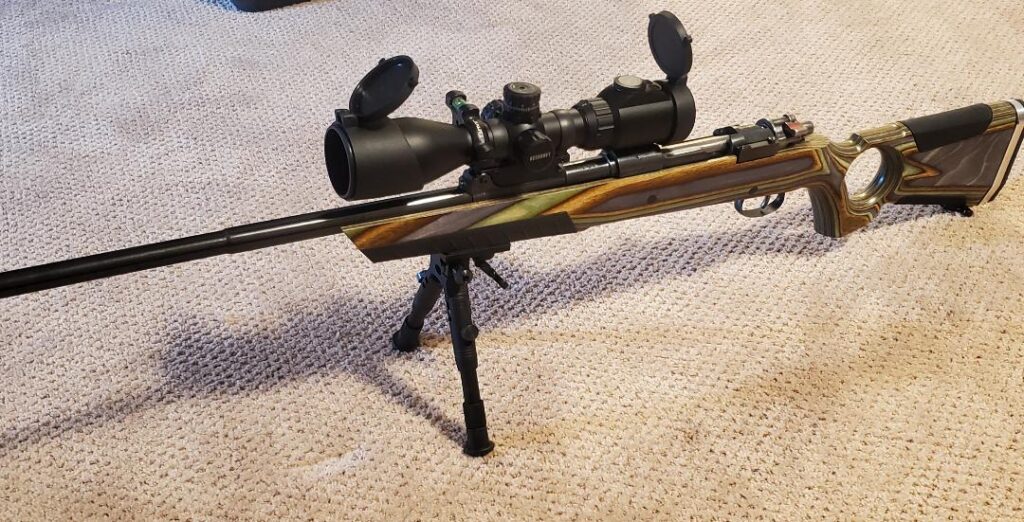

I know your concern is a 96 Mauser, but I am in the middle of the same type of project (more a "project" than worrying about the practicality) on a 98. I found a used B-square scope mount drilling fixture on ebay and drilled the receiver myself. The fixture worked really well! The holes are perfectly centered and they aligned with the pic rail exactly. I'd read a lot about Mausers being hard to drill - mine was not. I used a freshly sharpened #31 twist drill with the bushing in the fixture, a drill press a medium speed with medium pressure. Tapping also was easy with a new Hanson tap. I made a "tapping" bushing for the fixture, which also helped a lot. My experience for what it's worth.
