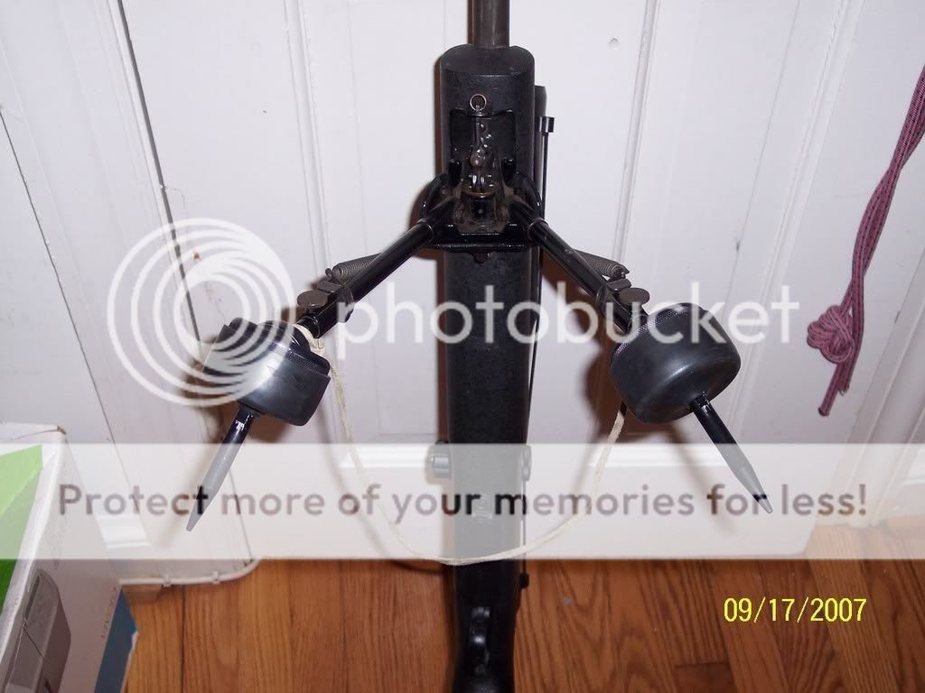

Spiked bi-pod... :thumb:
Tiny group with spiked bi-pod :D
