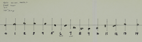

I think his theory only represents one aspect of barrel movement. A common thing using his calculations is that most say they get you "close." Using a tuner, it's very clear that there are multiple sweet spots and they are relatively "close" together also. What I'm trying to say is that tune just repeats over and over again. The distance is based on the natural frequency of the barrel. With a tuner, we are slightly manipulating the frequency but more accurately, we are altering phase time. Essentially, this just means that we are shifting the top of the sine wave left or right to coincide with bullet exit. I'll post a pic in a minute. Don't read too much into the actual groups at this point but check out the very clear sine wave pattern on the target. This is a 100 yard test target. I'm not posting it to show that the groups are perfect or not, but that the sine wave is very apparent.
Exactly! The sine wave achieved by varying charge weights agrees with Long's optimum barrel time, whereas he only considers muzzle diameter swell. Kolbe's results also exhibit phase shift dominates frequency using a tuner. I need to write up my method to determine the barrel vibration frequency from a charge weight ladder.
