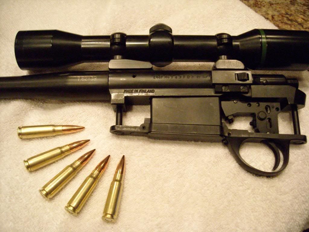

I am using the sierra 125 grain pro hunters.The gun(custom model 110 ) and was wondering if it would be alright on deer 100yds max distance.It equals and is slightly hotter than a 30-30 in my gun shooting at 2275. Any response is really appreciated.
No issue performance wise, you have more than enough power for any sized deer and you can also push the range further than the 100 yards you stated if needed. As with shooting any game animal, shot placement is much more important than the instrument that is being used.
I feel better now,I built it to be a soft recoiling rifle and it shoots under an inch at 200.
