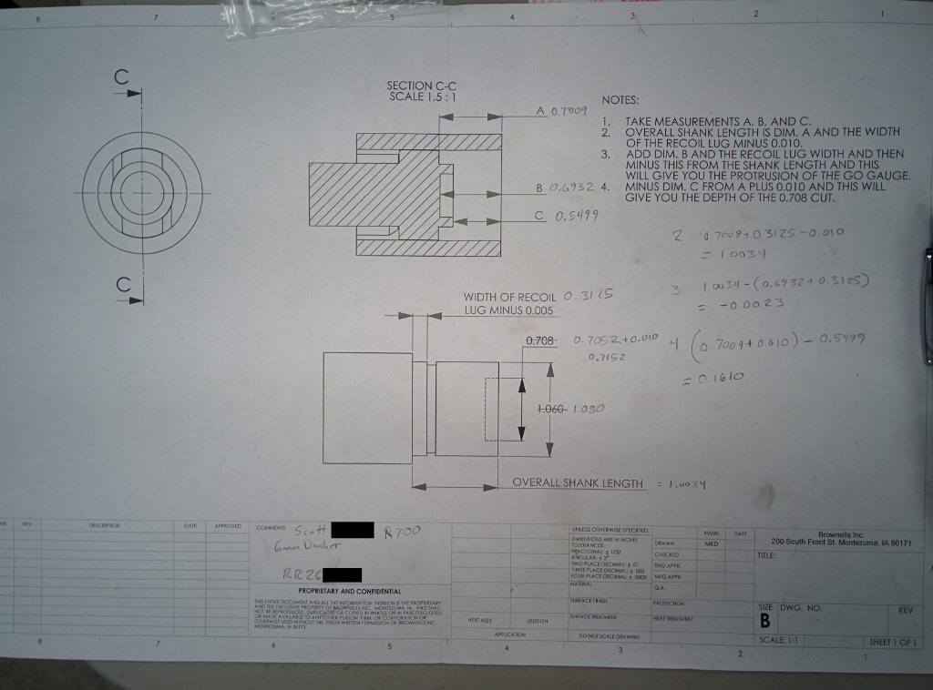

I have a customer that asked for "the blueprint" on a truing/rebarreling job I did on his stock R700 action. I have a document I downloaded from Brownells many years ago that I use as my own worksheet when I true up an action, and I keep this with my records along with any other notes, but I've never been asked by the customer for any documentation of such. I could give him a copy of my sheet, but it doesn't seem very professional. I was wondering what others do to document their process for the customer.
Maybe post up the original file for others to download?
I'm no gunsmith but I wonder how many actually measure the before and after measurements on that print you showed. I think a lot of guys do the truing and then just take their measurements they need to do the barrel job. And I wonder what measurements the guy actually wants. You could scan that document and fill in the dimensions. All you can do now is give him what you have. Really wonder where he is coming from.

Why would it be unprofessional,I include all the info in a file I can get on every rifle I have built.

Op , don't you true / face the receiver lugs ? If so that should be shown how much and how much the top was off from the bottom or bottom from top . Also how much runout in exterior , i.e. How banana shaped it was .
Just a few things I noticed missing

Thanks. That's useful. I do true up the lugs while the action is dialed-in, but didn't think that info was relevant so I've never measured before/after.
Perhaps I should try a different tack. What would you guys, as gunsmiths, like to see on a report to indicate that the smith knew what he was doing?
