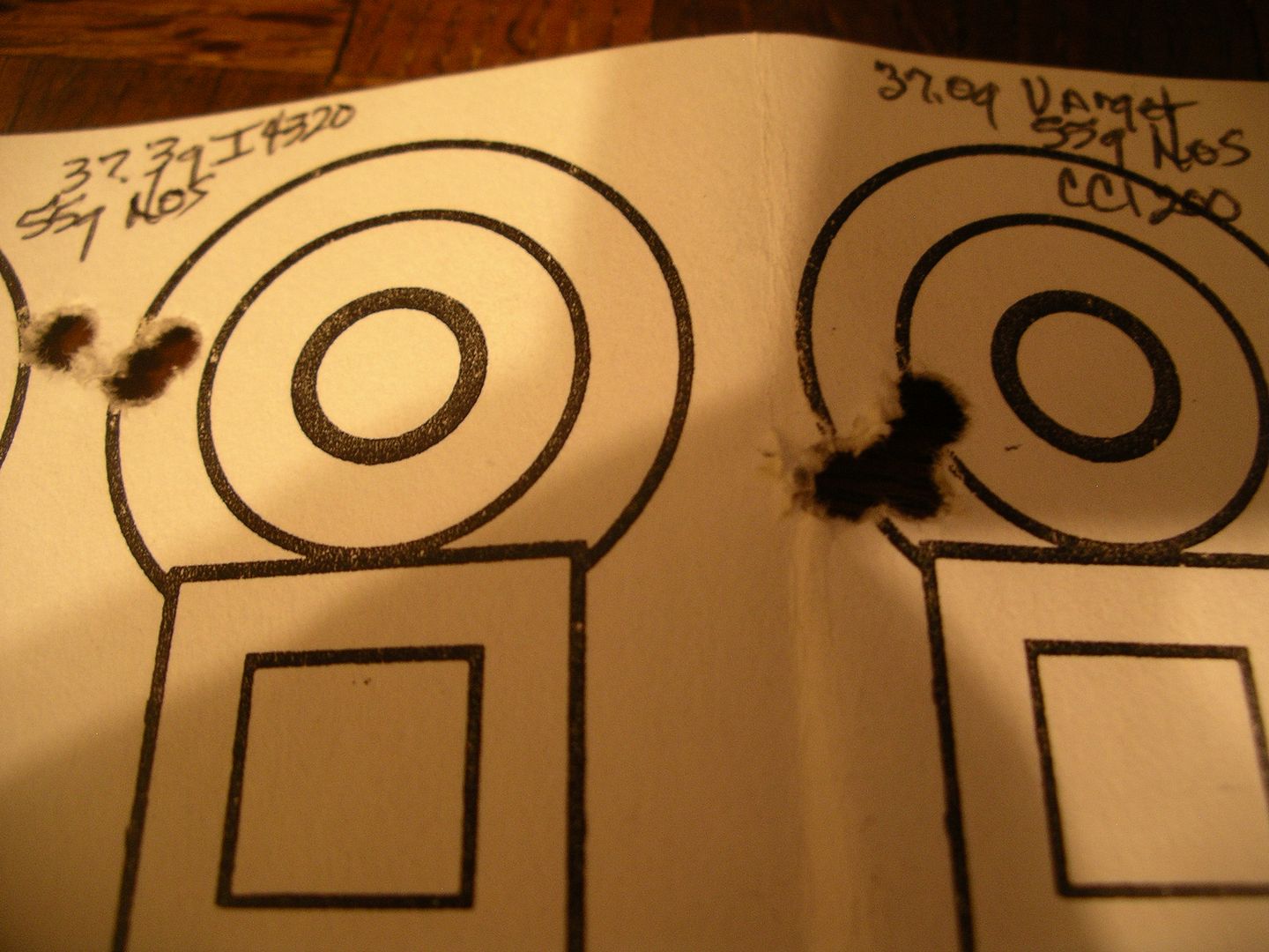

Not long ago, I shot these groups in a 22/250 AI barrel on a Savage single shot, IMR 4320, varget, wind was horrible. I had previously shot Win 760 with the 55's and they shot small groups also.
I am a firm believer in "Cleanliness is next to Godliness", I just have not seen how changing a powder at the rifle range when loading has destroyed the barrel's ability to shoot bug holes. When shooting my 7 Mags, I will change from IMR 4350 to R#22 then to IMR 7828, and then may go to Retumbo trying a 1.5g spread with each powder to see what that particular barrel may like. I will usually get some small groups with all powders where the bullets are all touching or much better.
A lot of these types of statements of cleaning in between powders is all about what makes you feel "lucky" or gives you confidence. Perhaps the wind is bad one day, you quit at the end of a string on a particular powder. The next time you come back to the range, the wind is more consistent or you are less stressed that day.
On medium size cases and small cases that are on benchrest quality rifles, I just have not seen a tremendous change in accuracy going from one powder to another while shooting 20-30 rounds of one powder, then changing powders. In fact, just the opposite is usually true. When I change powders, I usually find the next powder will shoot bug holes.
