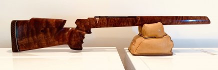

I offered to show another forum member how to make one of my stocks. Although he's hesitant, some other guys have asked if I would show them. I'm going to make copies of the patterns I use, send them out and then lead them thru the process. I'll start a couple stocks, describe how and what I'm doing and post lots of pictures. I'll do stocks for a Rem 700 and a Tikka. If any one else wants to do one, PM me your address and I'll put you on the mailing list. I figure that if I'm going to type it out , there may be some other guys that might want to do one. Let me know, Josh
I should add something. These stocks can be "tweaked" to your favorite style of shooting, during the build. They can be made longer, wider, have a flat bottom butt, etc. I usually make them with a 4-5" long flat spot on the forend for shooting off a rest. That area can be 2-4" wide or the entire forend can be wider. They can also be cut short and made thinner for a lighter hunting rifle. I'll be making mine repeaters with bottom metal but they can be made as single shot . The forend can be cut to expose the magazine or be cut flat from the mag well to the tip of the forend, like a prone Anschutz.

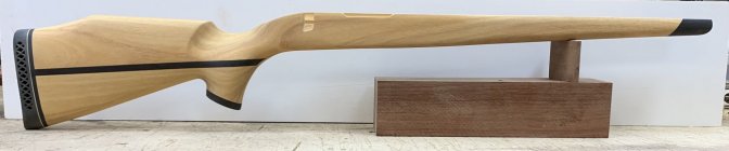

The blank should be 2 to 2 1/4 thick by 5 1/2 to 6 tall by 36-42 long. I glued up a blank with some figured maple I found at Home Depot and a piece of cherry I had left over. It is 2 1/4 by 5 1/2 by 36. I'm going to take a trip to a dealer soon, to look at some exotics. These 3/4 inch boards were planed when purchased so all I had to do was glue them up and clamp them. Glue is like grease between the boards when clamping so I put a couple nails at the ends to keep them lined up and square. The nails are in areas that will be cut off. I use TitebondII wood glue and as many clamps as I can get on the blank. White glue likes lots of pressure. A 2" blank will work but 2 1/4 gives you a little "room to breath". It's the old rule: You can always cut it off but you can't put it back. Kinda:D
If you want a stock with more drop in the butt, go 6" or more or you can glue another piece of wood on the butt. Look closely at the bottom pic, just forward of the recoil pad on the bottom.
I should say this, now. I never went to Gunsmithing school. Heck, I never finished college. This "build" is a layman's stock. There are areas where I will cut corners to make the build easier, faster and less technically challenging. I think the end result functions just as well without those details. I'll point them out as I go along and you can decide if you want to spend the extra time to deal with it. For instance, the mag well. I like the design because it allows you to hide a 5 round mag in it and you can support the gun there without putting pressure on the mag. It also "hides" a sloppy inlet. You need a flashlight to see any gaps between your bottom metal and the wood.:eek: Makes it sooo much faster and easier to do.:)
