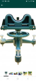

Thinking about starting a company: Newton Redneck Gunwerks! I purchased a scissor jack for $30 and a lab jack for $16. I took the top off an old Caldwell rest I had, along with the hand wheel. Two springs take any slack out of the jack up front.IMG_1632.jpegIMG_1632.jpeg

That is different, to say the least. If it works, that’s the main thing.
I give you an A+ for thinking out of the box.

That’s cool! So far my system works fine.
