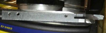

I just bought a nice used pair of Mitutoyos off a guy from Ebay for $60. I had him take a few extra pics for me so I could make sure they were real. He had no issues with it, which makes it nice that he's not trying to hide anything. And he assured me they were genuine. Can't wait to get them and put em to use.

I know my Peacock dial calipers are dead nuts everytime. The jaws come together like glass and always to zero. If I don't like these digital Mitutoyos, I'll just send them back and get refunded. How do you check the resolution and accuracy with them?
