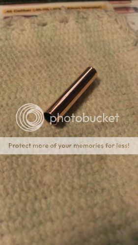

Think Berger will replace it ???? Hopefully with a whole box of same lot...Ha Ha Ha !!! Never have I ever just got a cup in a box. anyone else get one of these?
rmist (Boy you keep things neat!) Never found one of those in a box of bullets, maybe they are trying to get you started in making your own. Looks like what you have that are only .002 off are good to go, all I do is make sure there all the same length and same lot#. This has been talked about quite a bit, The big difference will be seating depth if they are way off from each other, so you have got to find which ones your rifle likes then keep hoping when you get another lot # that there all the same again. Have fun.

rmist said:
Think Berger will replace it ??? ? Hopefully with a whole box of same lot...Ha Ha Ha !!! Never have I ever just got a cup in a box. anyone else get one of these?
[br]
Didn't get a cup, but this is supposed to be a Sierra 190 MK Moly. You got just jacket, I didn't get enough jacket. How would this one sort? ;)
