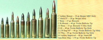

What's the difference in the 3 cartridges, speeds, advantages and drawbacks, etc? Anybody have a picture of all 3 cartridges next to each other?

I appreciate the picture! I didn't know the K-Hornet was a 22 caliber. I always thought there was 3 kinds of 17 Hornet, that helps clear it up a bit. I'm glad I got the CZ 17 Hornady Hornet, it's a super accurate rifle for me.
