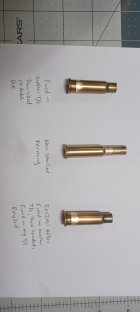

I bought some formed and fired 30 Herrett brass from a guy, anticipating buying a barrel for my Contender someday.
I bought an RCBS 30 Herrett FL die, seat die and Form/trim die from ANOTHER guy, later, same reason.
I bought a 30 Herrett barrel from a THIRD guy.
Today tested the brass from guy 1, which had been fired in his gun. With no sizing it fit fine and the TC passed the cock and fire on a dead primer test for headspace.

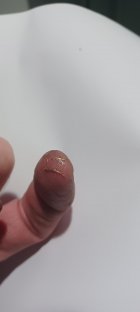

So then I sized that fired brass. A couple things happened. First, it grew in length from 1.605 to 1.610. But more glaringly, it shaved off a tad of brass near the base (see photo). I barely bumped the shoulder because these guns shoot best when the shoulder is tight to the chamber/breach face. At that time, since the brass I was sizing had been fired in another gun, and the "shaving" seemed to occur mostly on one side, not all the way around, I surmised that the guy who owned the brass had an infamously TC barrel...with a egg shaped chamber. I decided I could live with it. I trimmed the cases to 1.60, the TRIM TO length, then loaded 16 of them with 23 grains of 4227, a WLR primer and a 125 Sierra SP.
Off to the range where they all fired (good, no extraction issues, though one was tight, and all went off, so no headspace issues).
Back home tonight I decided to size all the rest of the brass and prep it for load testing, as I was unhappy with the groups I shot. TC can be finicky, so I was not surprised at that.
I first sized the brass now fired in my gun. This time it took off MORE brass, all the way around. Ok, my chamber isn't egg shaped, but it is larger. The cases grew back from a "timmed and fired" length of 1.601 ish, to 1.605. That seemed to be a bit much in my mind for case life! But more frustrating was the shaving on the sidewall.
So for giggles I pulled out a new 30-30 Starline case (for once I decide on a bullet I like) and ran it into the die. It sized easily for step one of making Herret, with no shaving.

Should I be worried about this RCBS die taking so much off (see my shaving on the "finger photo")? And I might add it sure seems like it is the non-radius edge at the die entrance that grabs it. My Redding dies don't seem to do that on any cases like my 357 Herrett.
And is there a solution, or is this a non-issue?

you need to polish the (at least) lower portion of the dies and add a small radius leading into the die.

Yes, the fired brass was fired in another barrel when I got it, and had not been resized. When I resized it in the RCBS die, it shaved, but mostly on one side.

Agree with post #2. Your die has a sharp edge and perhaps scored a bit inside but mostly try and get that sharp edge off. Thats the only way you are "shaving" brass.
you can shorten a die quite a bit, most dies have a mega chamfer at the base u can take .030 off easy and still have a good chamfer, I've taken off a bit off the base of a die, maybe someone shortened the die and took off the chamfer, so yes it needs a little chamfer to take away the peeling as Mr Warner Say's he is correct

Correct. There has to be a sharp edge. Don't understand the location where it happens on the case. The cartridge is well into the die before the cutting occurs??? Can you see a sharp edge anywhere on the die interior?
The bottom inside edge of a die isnt sharp. That one's been shortened. I've done it myself, but always re-radiused / broken that inside edge with a dremel. It's NOT hard to do, barely any work at all. OR.....get a new die.

Your die is causing this. The mouth of the die is sharp. It will do the same on any brass that is oversize and sized down.
Could be someone cut it at some point, maybe from the factory like that, for whatever reason.
You need some 1000 grit wet sandpaper and a drill press / lathe to turn the die so you can smooth that inside edge.
It will take some time, die bodies are very hard. Wrap a strip of sandpaper about one inch wide on a dowel stick, and angle it so it contacts just the inside edge of the die, while the die is turning. It'll radius automatically.
I've had the same issue on case walls, I can't remember when or what die it was, just that I had it and fixed it this way.
I also had a similar issue where my Forster die was doing the same thing to my 30-06 case mouth, on full length sizing, it was scraping to a millimeter or so below the case mouth. Also fixed in the same way.
