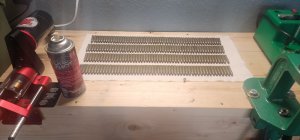

Thanks for the thoughtful response, Ned. I was worried that I'd post too much information, but now i see I left some critical info out. The scratches are indeed on the case body, not the neck. The scratches begin right at the shoulder and continue toward the base a little more than halfway down the case length. I'm going to try to attach some photos.View attachment 1493450View attachment 1493451View attachment 1493452View attachment 1493450View attachment 1493451View attachment 1493452
This doesn't look like a mandrel problem to me. Or at least, the scratches you're observing on the case body are probably not the result of treating the necks with a mandrel. Given your description of the brass streaks inside the die body, I suspect you would have observed those marks whether you used a mandrel first or not. Give Wilson a call and they'll take care of you.

Thanks, Webster. I chamfered the necks with a Lyman VLD tool, but I agree with you, it sure doesn't look like it. Everything I read advised that it didn't take much at all to chamfer that edge, so "don't got too crazy" on it. I guess I didn't go crazy enough.
More lube! I use Hornady One Shot and I've scratched cases like that simply from not using enough lube. The "ziplock bag and roll them around" method definitely does not work in my experience. I lay the cases out on paper towels with the necks facing toward me and then spray them so the lube gets inside the case neck as well as the outside of the body. Spray LIBERALLY, roll them 180 degrees and spray again LIBERALLY. I don't think I'd go taking sandpaper to my die at this point. If it's actually scratched, send it back and get it replaced. If I were a die maker and you tried to return a die to me after you took sandpaper to it, I'd probably not replace it. The likelihood that the dies have scratches all around the inside that are leaving marks like what are on your brass seems really unlikely. If you were consistently getting a scratch in the same place, then I'd suspect the die. I would clean up the inside of the die and make sure theres no brass stuck in there and that the die surface is smooth and scratch free. Douse the cases in one shot, and run them again.
