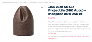

I am hoping to figure out the BC for a particular projectile. It's the 56gr. .355" Inceptor ARC for 380 auto. It's their fluted round nose copper/polymer pill. From the manufacturer, I'm not sure what the data they provide means exactly. In some load data they show "BC / SD - .037 / .067 ". I assume they are saying the ballistic coefficient is .037 with a standard deviation of .067. I don't know what SD means in this case. I haven't learned yet how to figure out BC when the manufacturer doesn't publish the BC forthwith or Google doesn't help tremendously. I am going to play with this projectile and reload it for both 380 and 9mm but I would like to punch the BC into ballistic calculators for some data prior to chronographing it myself. Can someone take me to school?

SD is sectional density. The 0.037 is the ballistic coefficient. You can look at the Hornady 90gr XTP and see the BC is 0.099 for a much heavier built.

I suspect the spinning flutes on the nose of the ARX bullet will create a lot more drag than a typical round nose bullet with the same mass and velocity.
