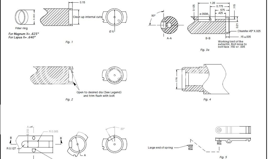

If you look at the print: (download here: https://www.badgerordnance.com/wp-content/uploads/2013/10/306-90_91_92_Extractor.pdf)
Of the pocket view
The issue is the cut of .115 doesn't appear to be deep enough.

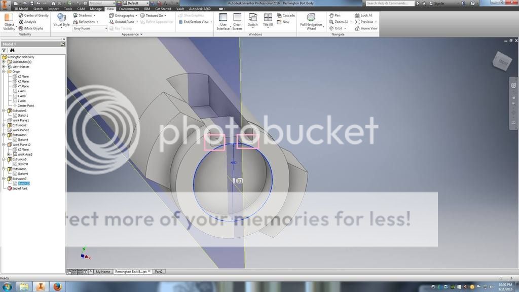

Here is to show my reference point (OD of the bolt) and depth is correct per the drawing. The bolt body is .696 OD and the bolt nose is (lugs forward to bolt nose) is 0.693OD. I'm measuring the bolt I have off my factory rifle.
It seems the correct way is to mill the slot deeper, but how deep? In the model I could use guess and check to find it would take .145 cut to get completely through bolt body to rid the area in pink squares above.
Don't know if this helps, but I just installed m16 extractors on 4 remington magnum bolts and the .115 dimension was correct. Maybe contact Badger and see what they have to say. Just a thought.

While I have the part and CAD model is exact copy of my part in hand. The print and the instructions aren't clear. Last think I want to do it cut to deep (ruin the bolt). Magnum and lapua are easily wrote out and .115 works. Standard, assumably, is for 308 bolt face of .475

I admit I'm stuck on the .115 number but appears to only work for mag bolts.
Doing some digging a mag face is 0.536 and standard is .475. Difference of .061. Half that is 0.0305. I had to add almost .030 to the initial .115 to get through the bolt on the .308. I could be on to something or its just luck that the numbers are really closely matching up.
Badger list 3 different p/n for the extractors each # corresponds to a different case head dia. Is it possible that the depth of cut is the same for all 3 P/N s and that the part itself compensates for the difference in case head dia.? If this was the case you could drop the tool down to clear out the matl in the pink boxes after the groove was cut for the ext. If the tool left a small radius on the soldered in ring in the corners where it meets the bolt face it wouldnt really interfere with anything. I only have the ext. for the lapua mag or I would measure and confirm. Hope my rambling is clear

I just did one yesterday on a Borden bolt, the cut was .140" deep. But its for a drop port and I do not want any pressure from the extractor on the case head.

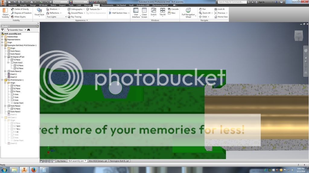

I've change my mind and going to a Mini. I have a defiance but it looks to be different than Badger in one small area. I'll have to call PTG to get a extractor print. I have model the extractor using my Defiance but I'm finding the dimension on the badger printer (hole location for one) is not working so I had to modify that.
I'm a drafter by trade so to make it "harder" I started to use Inventor with HSM Pro to learn a new system. Starting to like it better than Creo, which is what I use on a daily bases.
The space between the front vertical face of the extractor and the face of the case is 0.011
Also, 45 degress like on the PTG print is wrong, it will cut into the lug.
The 30 degree cut in to the lug a small amount but the 45 even more so, I'm assuming this is what you meant
