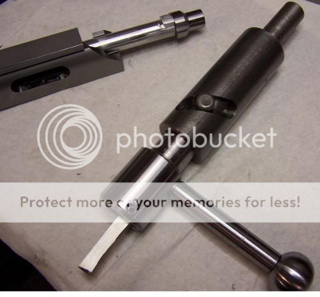

I am planning on a helical cutting tool that I still need to make. It is hard to explain but I belive there are pictures of this some where online. You make a "tube " and put a angled or helical slot in one side then insert a shaft that has a pin that slides in this slot, then attach a handle and cutter to each end, and postition the assebly over the action in the milling machine and work the tool back and forth and lower the quill,or raise knee) to determine the depth of cut.
I found the tool on practical machinsit. I had had something similar in mind now just find time to set up the 4th axis

I am now in the process of making the lug cam cutting tool and it should be done by the end of the week,if I can get the hang of 4 axis programing). All is cut and ready except the helical slot.

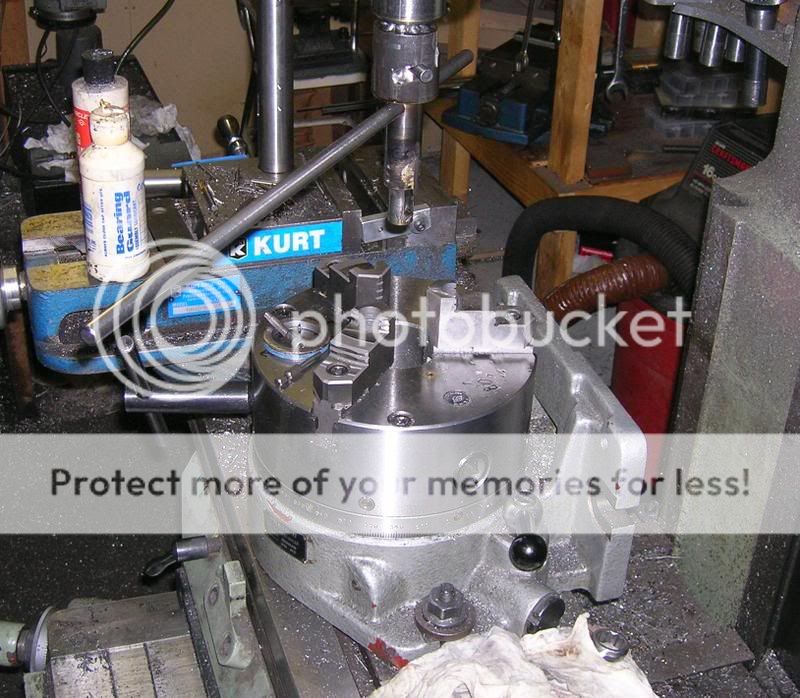

Have you given any thought about cutting the ramps using an endmill and helical interpolation? That's how Stiller cuts his. It will not cut a perfect helical cam, but it will be close enough to function perfectly.
I would like to know how that is done, because the way I picture it in my head the end mill would cut a dish shape and wouldn't be able to get right into the corner. The dish could be eliminated with several passes to smooth the contour but you would still have a fillet in the corner and in my design that wouldnt clear.
Another Idea I had was to use the 4axis HMC with a stationary tool and use it as a shaper.
fusionrider
I can visualise what you are saying about the dish like path being cut, but what if you tilted the action so that the flat on the bottom of the endmill was on the same plane as the ramp? I think that could work?
KB
Thinking more about it, you would probably need to use something shaped like a woodruff cutter so that the shaft of the cutter doesnt touch and foul the threads of the action.Hope this makes sense?

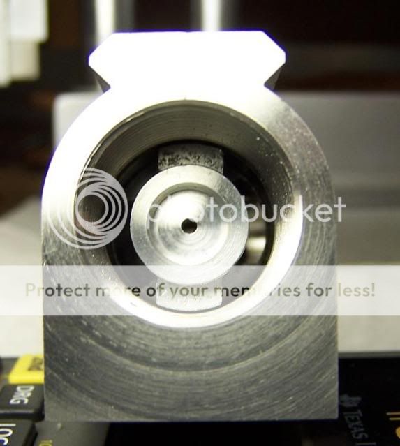

I recut many Savages to a corrected ramp. At the factory, they use a 3/8 endmill, which with the dished cut leaves the ramp higher on the outside. I use a 3/16' endmill, and make multple passes toward the center. I also make a secondary angle cut to blend the two so they are not as abrupt.You must remember that the leading edge of the bolt lug is riding this cam approx. .220' in front of the center line.

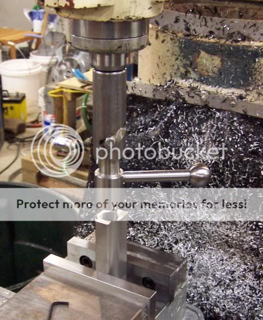

I made the tool to cut the clearance on the lug abutment shown at:
http://www.practicalmachinist.com/vb/showthread.php?t=172498 not the nice one, but the ugly one that also has photos of the finished cut.
The helical slot that worked best was cut with the tube in my super spacer and a 3/8 endmill on my Bridgeport. Sucessive cuts were made moving the table,X) .005 for each degree of rotation. Slots were cut at the same time/setup using .004 and .006 X movement for each degree of rotation. .005 worked best.
The cutting setup has the tool in the spindle but with the spindle locked, no rotation. The cutting tool is centered over the receiver. The cutter is moved through it's full range on each pass. The cutting tool ends it movement after leaving the abutment,pass compelted). The cutting tool begins it's pass before it begins cutting. The table is raised about .001-.002 per pass. The actual cut distance is quite short,see photos) and it takes less than 5 minutes per lug. Rotate Super Spacer 180º, lower table and proceed to cut second cam surface.
Can't provide dimensions as I gave the tool to a friend that was beginning to build actions for sale. Last I heard, it had cut hundreds of receivers. He leaves it setup in an old vertical mill and that is the only use the machine gets.

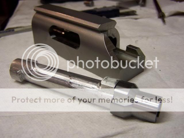

I started back in on the action yesterday and plan on messing with it this week.
I have the lug ramps cut and an aluminum test bolt made, all functions and works smoothly. :thumb:

Sorry for the progress dropping off. I am ready to cut the port for the trigger and drill/tap the action screw holes. The bolt shroud and cocking piece are done and I have a function testing aluminum bolt in it now. The mill and lathe have been busy in our shop constantly and tearing down the mills fixtureing just for this non-paying project is not an option quite yet.
