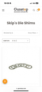

Have you ever considered Skip Shims as an alternative? They fit under the lock ring of the die. You can use them with any die and caliber of die.
I've used them for years as a means to make F/L die sizing adjustments without having to change the lock ring on the die. The set consists of the following thicknesses: .010, .008, .007. .006, .005, .004 and .003.
The best part is that they are inexpensive. I purchased mine through Sinclair many years ago, so I am not sure who markets them now.

Yes the shims can make a job but I don't find on browsnell...
As I said, it was quite a while ago that I ordered them. I think there are some other vendors now offering them. Perhaps some other members can chime in. I'll see if I can find an alternative vendor.
Maybe you can post a separate thread asking for info from other members. In the meantime, if I find a source I will PM you.
