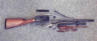

Max loads can generate a lot of excitement at the range.
The ambulance lights and siren draw lots of attention.
Lapua 40x,did the guy live through this? I have never seen a marlin lever gun sustain damage like this in my life.
http://www.thetruthaboutguns.com/2012/08/foghorn/marlin-lever-action-kaboom-nsfw/
If you're familiar with the anatomy of the hand you know that the median nerve passes directly below the area of this wound. If the severity of trauma is deep enough, the had becomes useless.
But some never learn.
