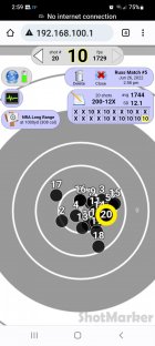

Put together 20 rounds with a medium load that is un tuned but safe. shot 3 rounds to Zero up at 1000yds. shot 17 rounds past the Lab Radar and ended up with a SD of 10 FPS and it held .79 MOA elevation with a random load. All this with my original bolt ( with the new firing pin spring) for the rifle.
Thank you to everyone here. Maybe this thread will help someone else as well.
