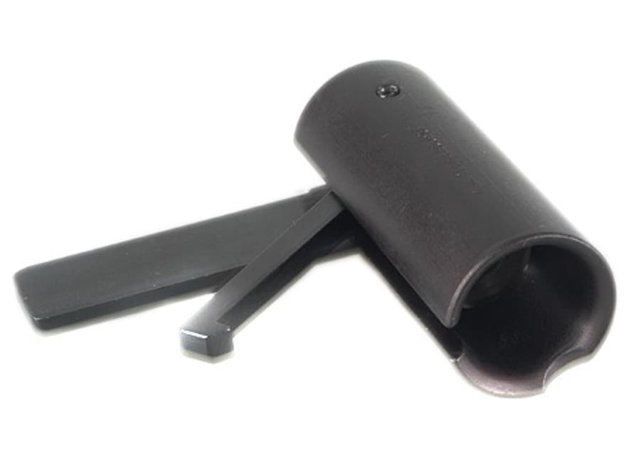

Using the action listed above I want to use the "Wheeler Method" to resize my fired cases. However, with my limited Internet experience, I can't find which tool I need to use to strip the bolt or instructions. Help.
Catch the cocking piece with flat on a closed pocket knife and pull it back. I use a flat bladed screw driver at my work bench. I can evaluate the spring strength while doing a quick 30 second inspection when a gun comes it.
A friend of mine demonstrated the Kleinhorst tool to me. (Thanks Aaron!) When searching to buy one, I found the Kleinhorst for $60 and a cheaper one for 1/2 of that.
I bought the cheaper one. It works, but feels cheap.
Were I starting over, I would get the Kleinhorst.
