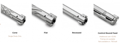

I'd like to build a PRS rifle one of these days, and have started doing some research. Can anyone educate me on the differences between these bolt noses? What are each of them typically used for, and why? I'm assuming the single-shot only is a bench-rest setup?
Cone is used as a single shot due to the difficulty in getting it to strip a round from the magazine (the taper of the shape doesn't give you a ledge to push the case base.) At least in theory. Bergara uses a cone bolt in their mag fed repeaters. Go figure.

#1 Cone - Bergara mentioned above -
#2 - Savage type?
#3 - Remington type
#4 - Mauser/Springfield/Win 70/Ruger type
I use a deviant on a bench gun it’s a single shot and came with the recessed nose which is the Remington style and works great
Get the standard flat bolt if you're building a PRS/repeater action.
^^^^ I agree. If feeding from the magazine the flat bolt is the way to go.
BTW - If you can wait a week and pony up a few extra dollars, Defiance can and will do custom serial numbers (or letters). And they have a military discount, unlike some of the other action makers.
All 4 of my Defiance actions including a custom from GAP and the PPR from GAP are recessed. All work great. If you want to go with a prefit barrel, some specify recessed nose. I know Proof specifically does for their prefits.

The Deviant Elite is different again. (You didn't include it in your snip from their website.) It is cone-nosed, controlled round feed.

The Badrock rifles have a coned bolt.
