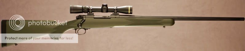

280AI is in my collection, and has done all asked ofit. very accurate, and moderat recoil from a 9.2# 700 with Leu 4.5-14 scope, considering your going after game of that discussed the heavier 7mm bullets available should be all you need.
in the 140's partition etc i get 3140 from a 26" tube, the 160's 2975 and i have not tried anything heavier. the 9twist should work for any of your choices.
