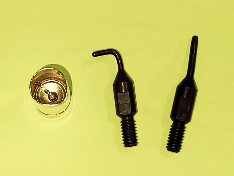

Mighty armory has worked great for rifle, but I've broken 3 pins in a few months with 9mm. The first was a sideways case sorta user error because I didn't stop when it felt wrong. I bent it back to get it out of the case. Second pin snapped in half on a 9mm, no pic. Recent one last week was the thinner Lapua sized pin on 9mm (because my 2 thicker pins were broken) and it bent 90 degrees on a slightly off center flash hole as seen in this pic. Disappointing performance, don't seem to be anything special. Maybe I got a bad batch? I just received replacements...

This doesn’t seem normal, do you think the shell holder hole wasn’t clearing the primer?

No, the pic shows where the pin struck the bottom of the case, scooted towards the case wall gouging the brass and bendingvthe pin 90 degrees. The flash hole is sliiiightly off center. Maybe the pin was also slightly bent prior to this case and this case was off just enough for the pin to not find the hole?
