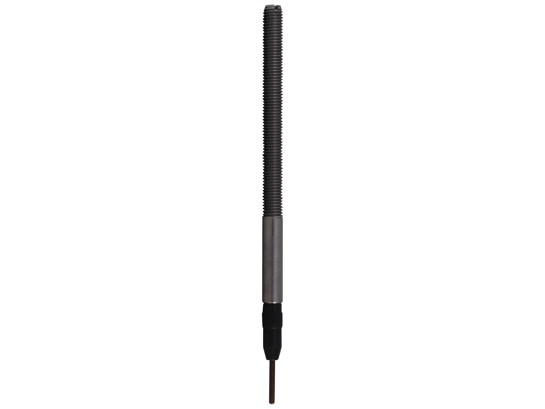

I have broke a lot of RCBS, Forster, and Redding decapping pins sizing military brass with crimped primers. I use a Universal Lee depriming die, now for 25+ years with zero problems.
I have an RCBS Swagger for large and small primer pockets for cheap money if someone need one.
I use one as well. I, however, have had a problem, namely the soft steel Lee uses for their decapping pins tends to mushroom at the tip after a bunch of use. I notice it first on my 32SWL brass; I can feel it hang up as the pin comes out of the flash hole (I suspect 32SWL has a smaller-than-normal flash hole, but have never verified it.)
Remove the decapping rod, chuck it in a drill and hit it with a file, and it's good to go again (for a while.)

I use a Lee Universal Decap die for decapping anything and everything military...............I don't use it for small FH stuff like Lapua........
I too use the Lee decapper. So far it has proven more robust than its more expensive competitors. If you don't think so tougher decapping pins for the Lee decapper can be found on Amazon for $15-$20 for a multi pack. For removing the crimps, while I have an RCBS swager I have taken to using a Hornady "VLD" case chamfer tool. Works great and is a lot less work :)
