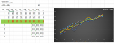

i ran my first 2 ladders for 223 this week.
speeds captured with a labradar
i just want to be sure i am reading this right.
the cfe was 5 shots per charge over 10 charges
the 8202 and varget were 1 shot
i highlighted in green the areas i will concentrate on.
will start in the middle and do 5 charges .1gr diff, with 5 shots each
2 up and 2 down.
just want to make sure i am on the right track.
thanks

Yup.
We all like it when the nodes are more obvious, but this is typical.
On the test where you ran 5 samples, it would be good to study those groups and shotfalls too. You may want to play with the seating depth as well.
Keep track of your environmental data too. CFE is great stuff for a ball powder, but watch for the temp changes in your coldest and hottest weather.
Good Luck and Happy Holidays.
