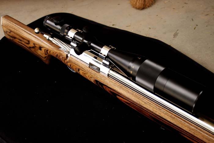

Dashers Maiden Voyage
Using the false shoulder method, turned cases, .020 jam, 107MK's and 28g of RL-15 the cases formed perfectly.
Accuracy whilst fireforming was 5 shots under .5 at 100yds. I am very pleased with the performance so far.
The HART barrel is amazing. Easily cleaned, and the running in of the barrel was excellent, the shortest yet.
THE RIFLE
Cheers
AI
1. Stolle Panda right bolt left port micro-port polished
2. Shehane Tracker in Light french walnut/ dark english walnut laminate
3. Hart 28" HV 1-8 twist barrel
4. Jewell 2 oz trigger
5. Kelby high rings polished
6. Nightforce 12-42 NF NP-R2 reticle
7. 0.265 neck
8. Redding Type S dies, using a reamed 6mmbr Competition seating die.
