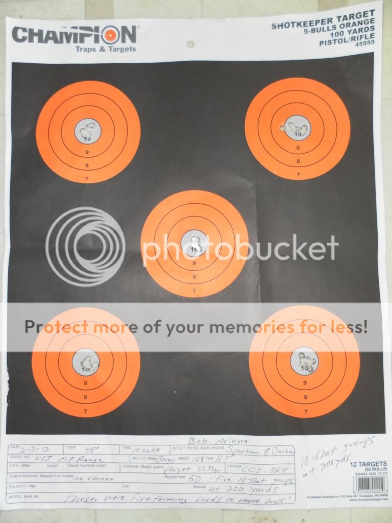

I'll be the contrarian....mine shot lights out with 30.5 of Varget and 108BTs and virgin brass jammed .030. These are 10 shots at 200, 1" ten rings.
In fact it shot them better than my some of my later loads!
