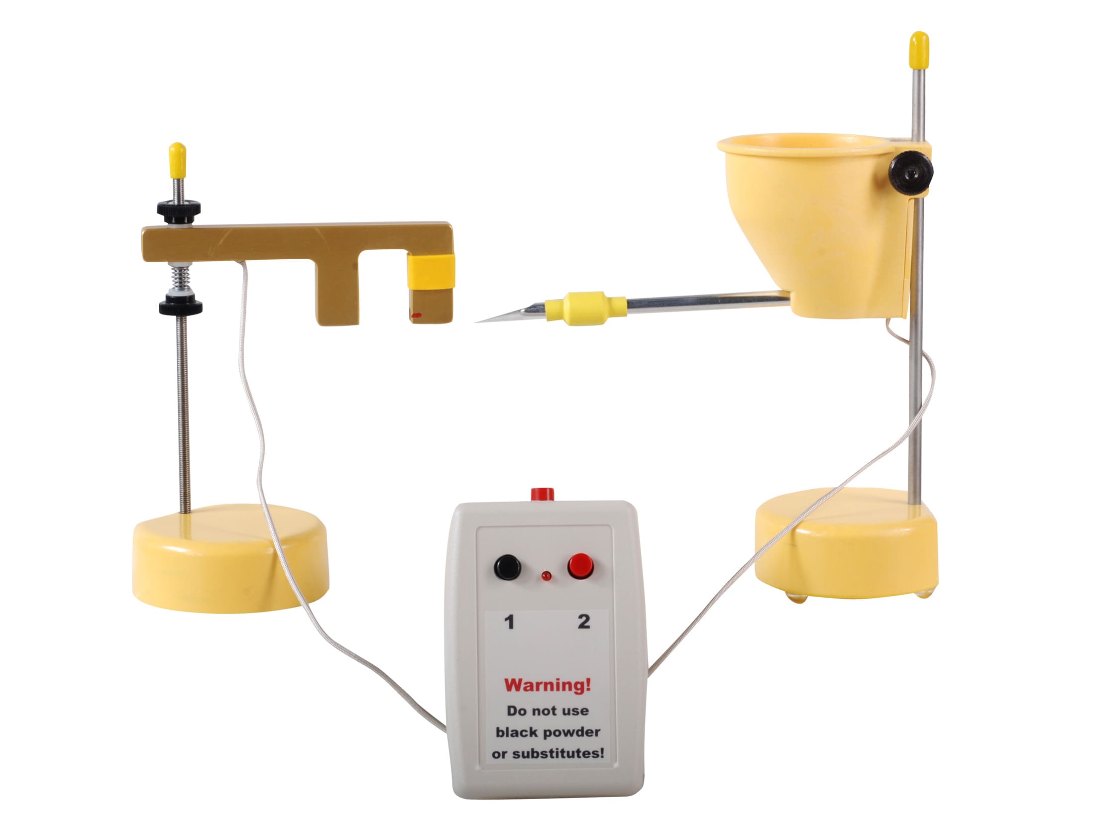

I have one of the tricklers mentioned in the title.
I have one question for those that have and use one. When I press the button to start trickling, it vibrates momentarily at a higher speed, then slows down for the remainder of operation till the powder scale beam shuts it off. When briefly on high speed, the powder bounces around quite a bit in the tube, but starts trickling once it has slowed and is running. Is that normal operation?
Danny
Yes, normal operation - The auto-trickler uses full power to initially latch the relay so it continues to run until the photo-beam is broken.
(I designed and made the prototypes of the auto-trickler for Dandy)
