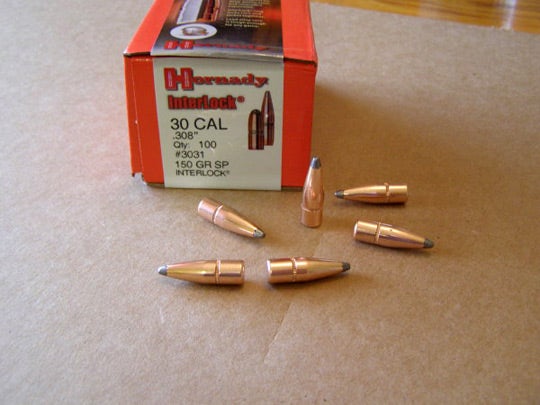

I have two experiences to add:
Drove over 220 miles to a match and realized that the 77gr TMK load I had grabbed was for a bolt-action .223 - I was shooting an AR. The bullets were loaded to 2.295".... The magazine could only handle 2.270. I chopped/twisted/hacked the tips off of those TMK's with a pair of side-cutting pliers and they shot the same as any other day. Thankfully the recipe for that rifle was very similar (24.6gr Varget, BR4's, Starline for both rifles). I was curious enough to try it again when I got back to my home range and only noticed margin-of-error deviation in group size to 300 yards. I did get a couple of "flyers" at 300 yards, but that also could have been me.
I had a match last year at my home range, PRS this time instead of a leg match, and I got home from work (I am a north slope rotational worker) to find no ready ammo for the .308 I was bringing. I loaded 150 bullets after getting off the plane into the wee hours of the night. I took a few hours nap and started loading the truck when I glanced at my Chargemasters - one was set at 44.5gr and the other was set at 45.4gr.... I pulled all of those Juggernauts with an RCBS collet puller and recharged each case to 44.5gr and then seated them back in. I made it to the shooter's meeting and had a good enough showing for the match. After the match was over I had 30 bullets remaining and I was at my home range so I shot them for 5 shot groups at 100yds and they were exactly the same .3ishMOA as any other group I get from that load in that rifle with absolutely no POI shift. During the match I was banging steel 5 out of 6 at 1190yds.
These two experiences, and some talks with manufacturers, lead me to believe that a bullet can take significant damage almost anywhere except the base and still be "good". Probably not long range benchrest, but certainly field practical.
