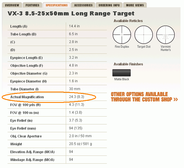

How do you determine the magnification of a scope? What kind of tool or device did you use? Are the other high end brands up to measurement?

It is the literature direct from Leupold.
Spec's tab:
http://www.leupold.com/hunting-and-shooting/products/scopes/vx-3-riflescopes/vx-3-8-5-25x50mm-long-range-target/
JB
The max magnification of the Leupold 8-25x50 LRT is listed in the spec sheet on the Leupold website:
Sometimes it pays to read the fine print, eh? ;)

Scope specification sheets are done by marketing people not optical engineers or mathematicians:
'Obj. Clear Aperture 2.0in/50mm' of course 2.0in = 50.8mm or if you would rather 50mm = 1.9685in. So what is the 'actual' value for this performance/design critical parameter.
If that isn't bad enough note that it is standard practice in optical design to specify design parameters for a telescopic sight with the eyepiece set at the '0 diopter' position. So if you actually use the scope at another diopter setting to suite your own vision then the 'actual magnification' changes proportionately,0.25x per diopter). Leupold and Stevens has in the past specified some of their scopes minimum magnification such as the HBR 6x which is 6x at the most negative [-2] diopter setting per an old spec sheet but no mention is made of the apparent magnification at other diopter settings,that could draw unwanted discussion relative to the 6x HBR magnification rule).
