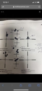

Only ever purchased 1 cz rifle cz 457 mtr. These are some of the very first targets i shot with it and some are ones after figureing out how to shoot it accurately. Mine seems to shoot any ammo through it cci std to lapua. It outshoots the test target with ease keep in mind test target is one group only. And who even knows how many test targets they shot untill they had one that passed their standard. Or if they even shot it at all at that computer generated target. Here is a 50 shot group one cold clean bore 5 shot group i packed up and went to the pistol range after those first 5 and a target with different ammo with a group average. And my test target pic. This is my experience with just one cz rifle. Good luck with yours
20220118_063119.jpgScreenshot_20220118-062938_Gallery.jpgScreenshot_20220118-062605_Gallery.jpgScreenshot_20220118-062526_Gallery.jpg
