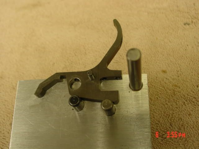

Pictured below is my 452 trigger.
Craig the 4-48 trigger adjusting screws come up from the bottom of the trigger shoe. Shown is the fixture that I made to drill and tap the 3 screws. In the pic you cannot see the springs because they weren't there at this time.
That's neat! It looks like a very precision trigger. The setup that I used was a real pain to install. Now that I think about it the installation included a spring with a ball bearing on it against the sear. Of course the ball bearing is never to be found somewhare on the shop floor. I remember that I took a small fillister head screw and turned down the shaft so that I could insert it into the spring and I used the fillister cut to hold onto the sear. This gave me a captured surface and a notch for the sear to hold it's position on. I've had it like this for years and it has worked great! My trigger pull is about 9 oz. When I go to use this gun, I dry fire it in position several times as it is quite a bit lighter than any other trigger I use. I like a Prone gun trigger to be 2 stage and 1# + 1# I have shot that setup for over 30 years. I used to have a Medesha 2 stage M70 trigger That helped me get on the first page in the Wimbledon and the Leach. Since Scott quit making them, we went to the CG-Extreme (Davies) triggers. I think that your setup will be the hot setup for the very accurate CZs
