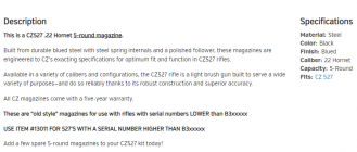

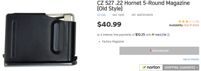

Looks like anything after a certain serial number uses the different magazine according to GunMag Warehouse. Not sure what they mean where it says discontinued? Does that mean they just don't try to stock these any more, or that they can't because CZ doesn't support it? Anyway, here is a snapshot of the new style. Good Luck.
