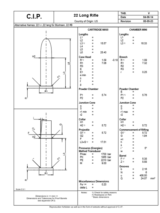

The Czech Republic is a CIP member state. CZ is located in the Czech Republic. CZ makes its firearms, including .22LR, in conformity with CIP regulations.
CIP publishes the specs for the minimum dimensions permitted for .22LR chambers. The "CZ match chamber" is closer to the minimum dimensions allowed. What the exact dimensions of the "CZ match chamber" are is not made public.
It's worth noting that since CZ's non-match chambered firearms are expected to be able to use a wide variety of .22LR ammos, including those that may not chamber well or at all in "CZ match chambers", it can be expected that these firearms will have more generous chamber dimensions.
Below is a diagram showing the CIP .22LR dimensions.

It's not clear on what those sizes are based, but they are neither CIP nor SAAMI.
Below is a comparison of CIP and SAAMI specs provided by CZ.
CZ lands and grooves are supposed to meet CIP specs. North American factory .22LR are supposed to meet SAAMI specs.
5.38mm is 0.2118"
5.58mm is 0.2197"
5.51mm is 0.2169"
5.64mm is 0.2220"
