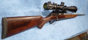

I bought my 457 American not long after they first came out - really liked the proportions of the sporter stock and the new features of the 457 action, including the fully adjustable trigger, bolt stop lever, 60* bolt lift, and the new investment cast trigger guard, which looks much nicer than the stamped ones on the 452-455 actions. And the action fed, extracted, and ejected very smoothly, with 100% reliability. The stock on mine also has some pretty wood. But, it didn't shoot worth a hoot, not with any of the std vel SK & Lapua ammo I tried in it, even though all that ammo shot great in my custom 40X repeaters. I borescoped the bbl and wasn't impressed with the lands in the leade - looked like the chamber was cut with a dull reamer, and the lands were 'smeared' rather than cut cleanly. The crown at the muzzle was also rather ragged, so I pulled the bbl, dialed it in on the 4-jaw in my lathe, and cut a new 11* target crown which cleaned up all the ragged appearance. The new crown did improve groups a tiny bit, but not being able to get any 5-shot groups at 50yds under 1-1/2" was not impressive...certainly not what I was looking for.
So, I ordered in a Shilen #5 select match ratchet blank, parted off the 1.20" diameter shank, and turned the transition radius down to form a fairly snug tenon. Chambered the Shilen with an EPS reamer, got the headspace set at .042", then cut the extractor slots with a slitting saw in the mill with the bbl held in the 3-jaw chuck of an Enco Super Spacer/indexer clamped to the mill table. I mixed some CeraKote graphite black & tungsten in an attempt to match the action's nitride finish, got the bbl de-greased, blasted, coated, and cured, then glued it into the 457's bbl socket with Loctite #609 retaining compound and let it set overnight. I know that sounds like a lot of work, but as mentioned, I was really impressed with the new 457 action, and the stock was really nice (not fancy like some of the 'wood lottery' winners I've seen posted on RFC, but still nice). I thought it was worth the cost & effort to find out how the rifle would shoot with a quality custom blank, and wasn't disappointed. The Shilen #5 contour is about 1/2lb heavier than the OEM pencil bbl, so I had to sand the bbl channel a bit larger, but the little bit of extra weight does feel good on this rifle, especially when shot offhand. Have never regretted giving this rifle a 2nd chance, and always enjoy getting it out to the range, whether just plinking, or trying to print some decent groups with it.
