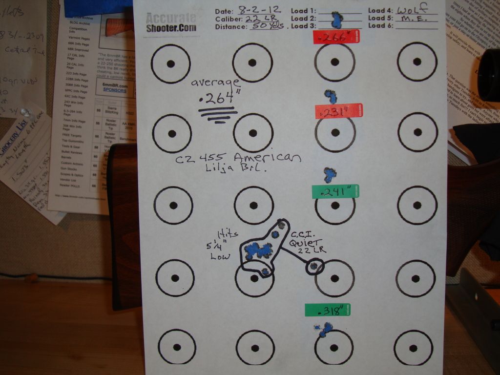

I've tried most all the options on 455 triggers and the YoDave kit seems to be the best. The trigger will end up being somewhere right around 12 ozs once it's set up to be safe against accidental discharge and it's got no creep or over travel. You can't get the others this light safely and the cost is to good to pass up. It's the way to go. Then drop in a Lilja Varmint contour barrel and your set. It's a lighter barrel that fits in the standard stock and gives the rifle proper balance unless you have a Heavy barrel 455 to begin with, then you go for the .920" model. Then have the stock pillars bedded by djdilliodon and you will have a rifle that shoots with the 54 actioned Anschutz models. 1/4" 5 shot groups at 50 yards with cheap federal AE22 high velocity ammo.
these are the groups shot with Wolf target before I had the rifle bedded.

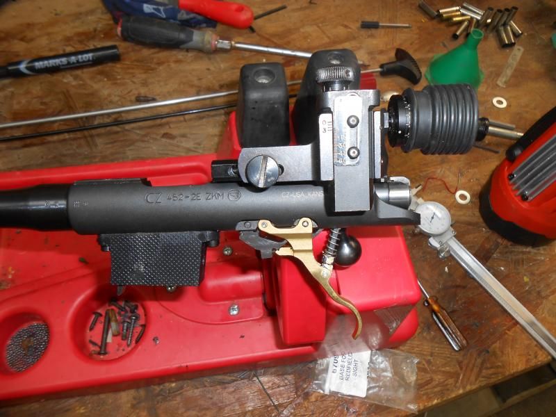

this pic is from my 452 UL but the sear is the same design,,instead of shims it puts a set screw in the sear to set the creep and with the right spring I can get to around 7 ounces and be safe off a bench,,I wouldnt want it that light in the woods,,
and a little trick to keep the ball in the sear while reassembling ,,push the ball and spring back in the sear and put the clip through the holes to hold them in
