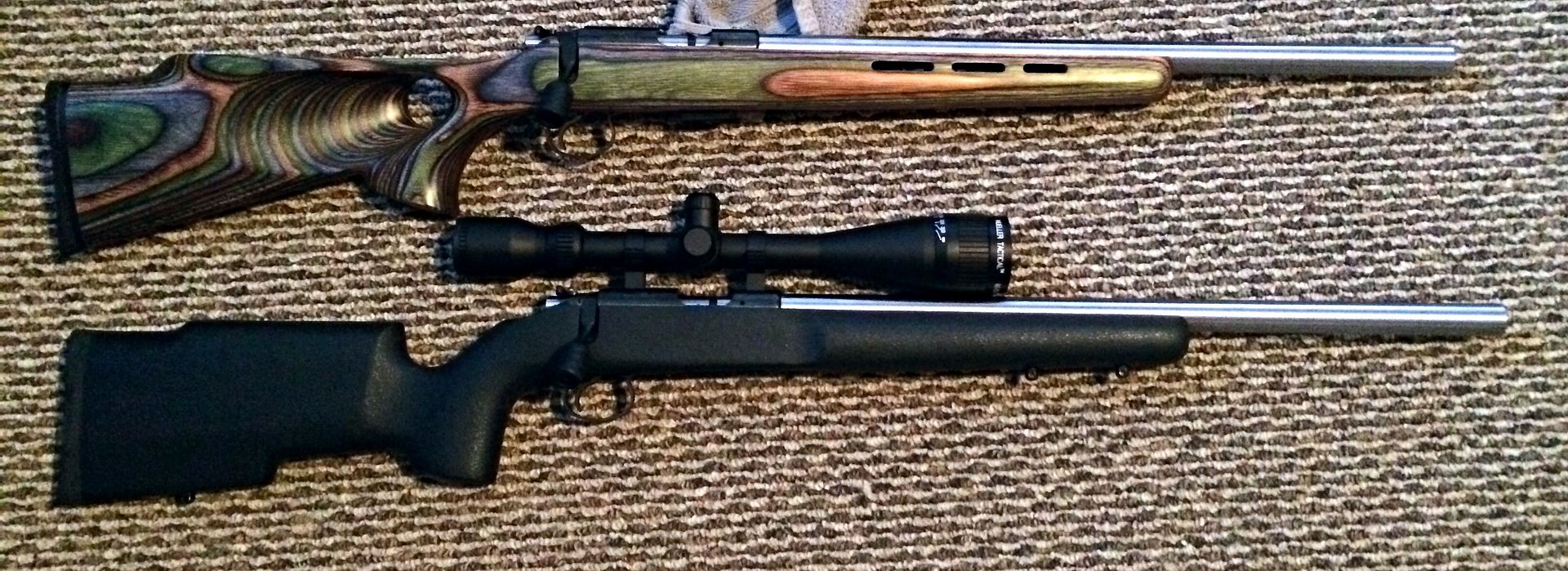

CZ 455 American
I have two CZ 452's, essentially the same as the 455 except 455 has interchangeable barrels and two action screws.
They are accurate shooters, but not at the higher end of benchrest competition by a long shot.
