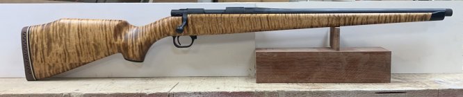

I have a 1903 Mannlicher Shoenaur that has a barrel that is about a half inch too long. It is at 19 inches long from the bolt face to the muzzle and needs about a half inch taken off to make it correct for the stock's fore end. I was told by a gunsmith that this would not work in their lathe since it is so short. I'd think shorter is better in a lathe, but I'm not a machinist. Also, if there is anyone in the upper Midwest you all could recommend to do the work on such a rifle. Here's what it should look like. Thanks in advance.

It just needs a half inch off the end to make it flush with the full stock like this image.

The sight ramp might need to be removed so the barrel could go into the lathe without issue, but it would go back at the same location. Its an annoyingly small amount of material that needs to be removed. That photo is of a correct muzzle end, not my rifle. Just add a half inch to the protruding barrel in that photo and lop it off to meet the End Cap, and you have my project.
