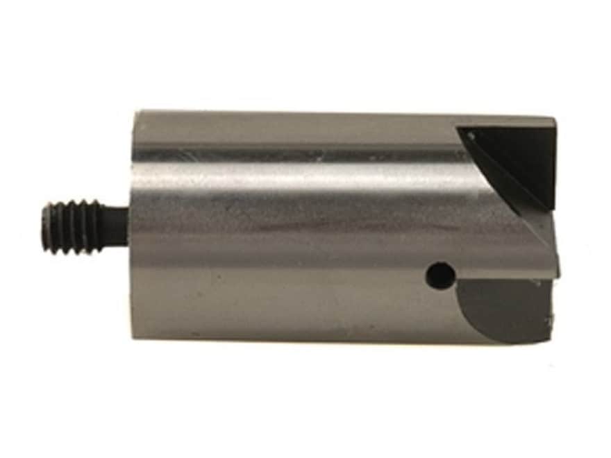

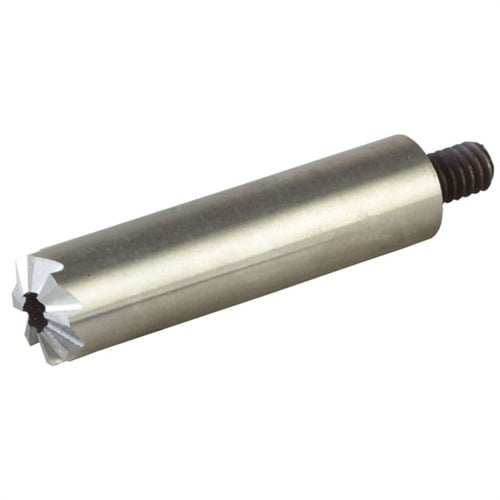

I've cut off some Contender rifle barrels back to 14" and 15" for use on pistols and used Brownells barrel facing and recrowning tools with excellent results. It uses pilots and so the cuts are off the bore.

I've shortened a couple with a fine toothed hacksaw. Taped the barrel and marked it straight so the cut was straight as possible. Filed flat using a black Magic Marker as a guide. Finished with a piloted Manson crowning tool. Turned out well on huntin' guns where an indicated crown wasn’t needed or practical.

I've cut a few, with a new hacksaw blade, a fine file and then used the Brownells 90 and 79 degree cutters. Actually improved the accuracy in one of the rifles. The Remington 700 VLS in .223. had 26" barrel, cut down to 22". Shot better with the shorter barrel. Eventually got replaced with a Krieger. That one was MUCH better.

Ive cut down several of the semi auto and one of the pump action Remington's. A gunsmith in central Florida who I never knew his name decided that the rifles would benefit accuracy wise if they had a shorter barrel. The cousin of my hunting pardner brought me several to cut down I bought a Brownell's muzzle cutting tool and a 30 caliber and a 270 caliber brass bore guide. I shot 2 of them after cutting them and they both shot better, one a little better and the other a lot better. I really wanted to hunt on the ranch that the cousin managed, so I only charged for the tools from Brownell's. He still owes me for one of them.
