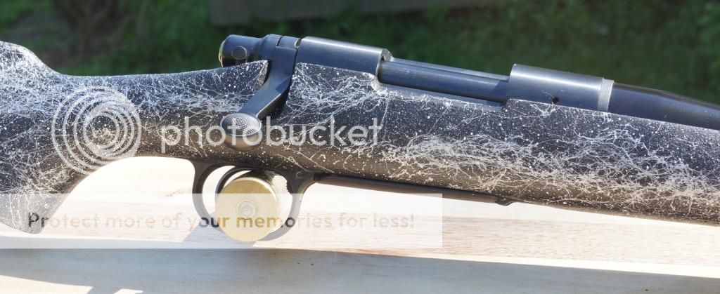

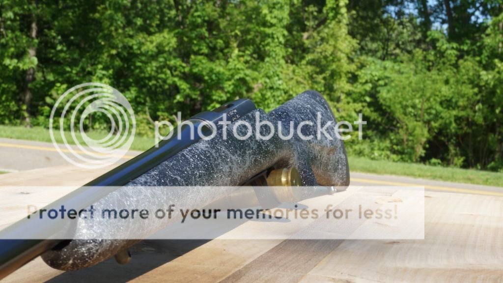

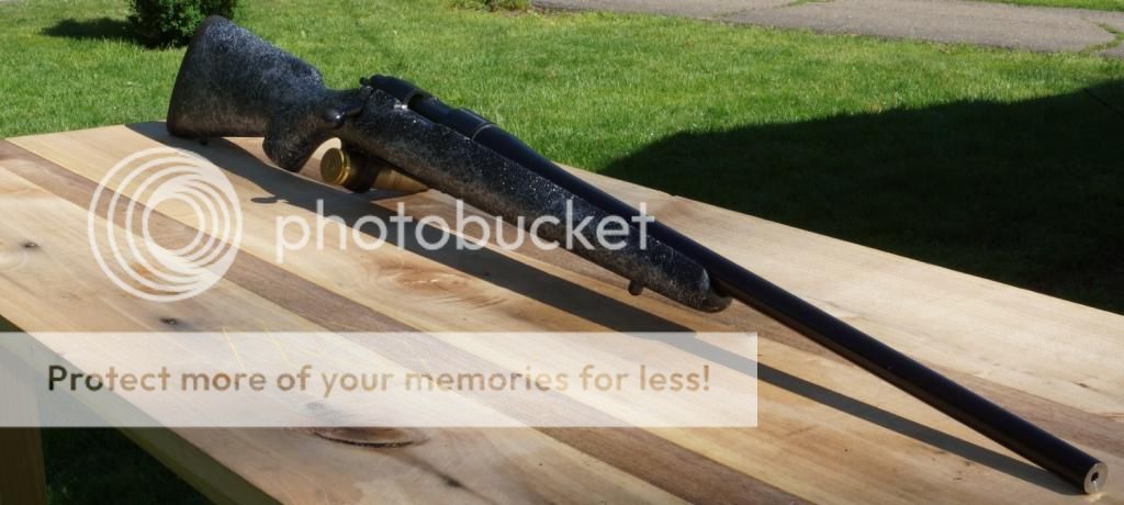

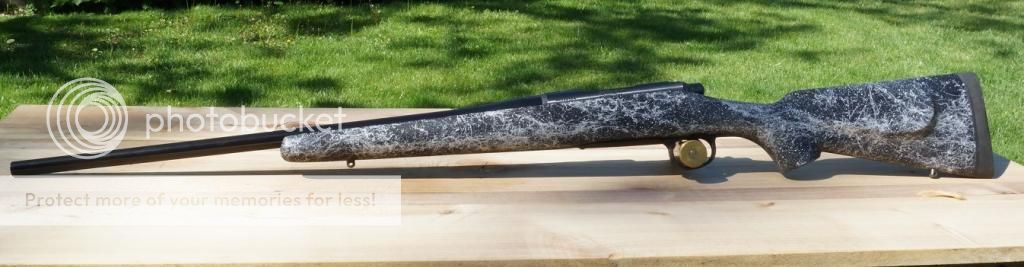

Custom Sporter 204R finished
ab_bentley
Banned
I fix stuff, sometimes....
Remington 700 Action
204 Ruger (.050" freebore)
Standard Bottom Metal (Alum)
Shilen Barrel 22" #3 Contour
Alaskan Ti Stock with custom paint
Barrel has DuraCoat gloss black.
(FYI, DuraCoat is the toughest(durable) product I have ever worked with. I used Aluminum oxide on a cured receiver to strip the DuraCoat, it wouldn't touch the stuff. Needless to say the pink paint stayed)
I believe the weight as it sits is near 7lbs, shouldn't break 8lbs with a fixed Leupold 6x.
Adam

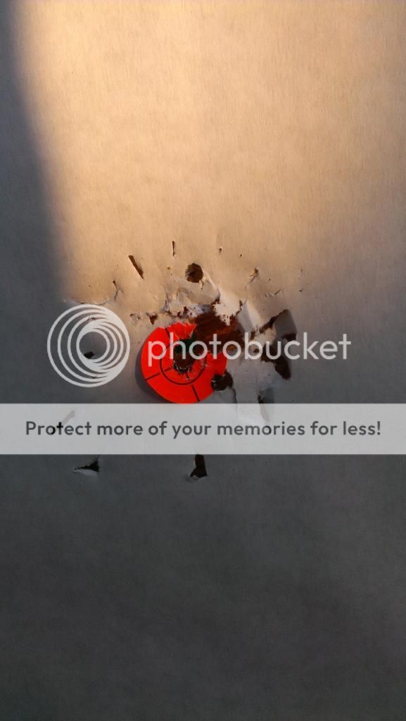

Well it's thumb tack accurate, 100yds, 40gr Hornady Superformance. It's very accurate, to the point I didn't want to let it go to its new home.
Adam
