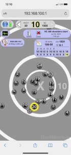

The pic below was shot at 600 yards using the brass with the .007 shoulder bump and sized with the SB die:
The next picture is brass sized by the FL sizing die with a .002 shoulder bump:
Other than a modest increase in X count which could be important, there isn't much difference in the two groups. About 50% of the brass that was sized by the FL sizer resulted in very mild clickers. There have never been any clickers when using the SB die.
I can't say for sure that all of the 9s were my fault but shot 20 on the second target was for sure. What I can say is that there is a lot of room for improvement in the gun handling department! There was really no wind during either string.
